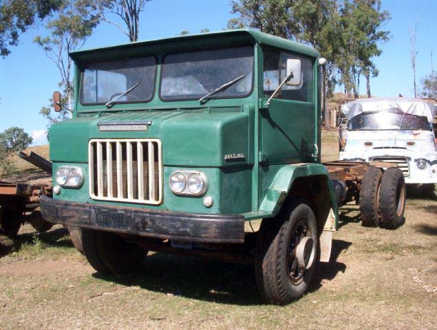

ACCO Mk.5 6x6

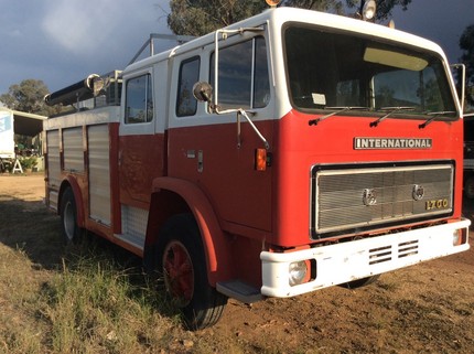

1980 International ACCO 510A
